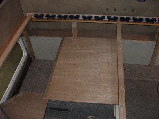

Der neue Trompetenfuß vom Barhocker hat nur einen Hub von 22cm um die
Schlaffunktion beizubehalten brauche ich 36cm!
The tablefoot is the (modificated) foot of a barchair (see foto)i have shortend the upper pipe so that the the footbar is dissapeared.
Manni here the solution for the problem! i wrote it in englisch becouse my german is not that good.
in the foot i welded a mounting strip, en the foot is bolted with a 12 mm bold through the bottom of the camper.it is stil possible too take the tube whit the gasspring out of the foot. When i need the place foor sleeping i have a separate short piece of PVC pipe which i can mount under the table witht the type of screws you can tighten en loosen with your hands so that its low enough too sleep on it. The table is also resting on wooden strips on de front of the banks )see my pictures'. I dont have my camper here otherwise i could send you a picture.
I also shortened the outer pipe of the tube wich contains the gasspring, from the spring itself i shortened the small massif rod. i did this because off the table hight. It was not possible to shorten it so much that i could use it too sleep on it. Therefore i used the solution wich stands above.
The position of the table foor is important because the stituation has also has to fit when the table is lowered and in this case the table has too rest on the wooden strips also.
I have another tip for you, i mounted the table foot not exactly in the middle of te table but excentrical. This has the advantage that when you rotate the table 180 degrees you have more space to sit on the banks and the table comes closer too the drivers seats.

Hallo Simon, ich habe das so verstanden:
Das Trompetenfußrohr dient nur als Steckverbinder und kann herausgenommen werden.
Die Tischplatte liegt auf den Sitztruhen auf und wird mit einem Tischbein abgestützt!
Gruß Manni:cheer:

und die Befestigung der Tischplatte auf dem Fuß ist asymetrisch. Dadurch erhält er bei einer Drehung um 180° mehr Platz zur Bank und der Tisch kommt näher an den gedrehten Fahrersitz!
in der Schlafstellung!Die Tischplatte liegt auf den Sitztruhen auf und wird mit einem Tischbein abgestützt!
Letzte Änderung: 26 Feb. 2009 20:10 von Lollo_C.
Re: Aw: Von Typ A nach B
26 Feb. 2009 20:24Jetzt hab auch Ich es verstanden geniale Lösung!in der Schlafstellung!
Wenn man sich das Bild mit dem Tisch genau ansieht kann man die asymmetrische Anordnung auch erkennen!

Genau,
Aber du brauchst keine seperates tischbein wie auf das Ebay bild steht. Ich habe selbst eine rohre gemacht welches in die fuss von der tisch montiert wurden könte.
Simon

Der Umbau von A nach B sollte eigentlich heute beginnen wenn mir nicht gestern in der Firma ,zwei kräftige Gasdruckfedern in die Quere gekommen wären:woohoo: ,und heute im Baumarkt verstellte mir auch noch ein Lattenrost den Weg.
Das Ergebnis von den Ereignissen war, unser Bett hat heute einen Lattenrost zum Aufstellen bekommen (vorher diente eine einfache gelochte Sperrholzplatte als Matratzeunterlage).
Hätte mir jemand vor dieser Bettenaktion gesagt wie schwer es ist ein Lattenrost in einem Hobby 600 zusammenzubauen und anzupassen (man steht sich immer selber im Weg):evil: , hätten wir weiterhin auf unserer Sperrholzplatte geschlafen.
Bei Wilfried sah der Umbau irgendwie einfacher aus!
Naja was soll’s bin fast fertig mit dem Bettumbau und meine alten Rheuma zerfressen Knochen werden mir diese unverhoffte Aktion mit Sicherheit danken!

Ja das ist nicht einfach zu arbeiten in einen Hobby. Auch ich habe einen lattenrost eingebaut und das gibt viel arbeit. Speciaal die unterstutzung von das lattenrost is nicht einfach. Leider habe ich kein bilder gemacht:1435:
Ich bin sehr interessiert nach die bilden von die umbau.
