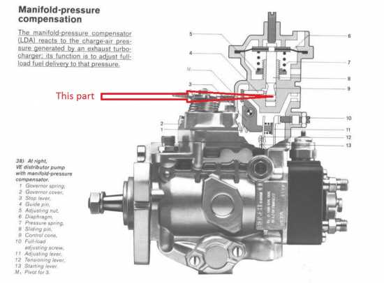

I can imagine that a rod of this type and a spring with less resistance can make a difference on a car without a turbo. Turbo is nice! :drive1:
Fuel curve is controlled by the # 4 and # 9.
Check this out www.306oc.co.uk/forum/showthread.php?tid=131&pid=90467

11 Feb. 2014 21:14 - 11 Feb. 2014 21:15janneh600 schrieb: I can imagine that a rod of this type and a spring with less resistance can make a difference on a car without a turbo. Turbo is nice! :drive1:
Obviously I mean #7 and #8. Not #4 and #9.

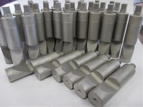

I have contacted a gentleman here in Sweden that manufactures custom parts.However, I have not received any reply from him yet.
Dem ser ut så här
:daumen2:

11 Feb. 2014 21:43
Them in the picture cost 800sek (90eur)
Availability, I have not received any reply from him.
The same type of stick is also mounted in for example wolksvagen.
The stick is originally from Bosch VP pumps for industrial use.

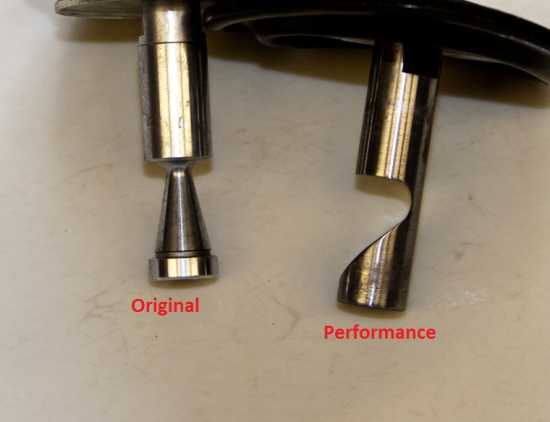

I've found a cheap stick..
www.brickwerks.co.uk/index.php/ve-boost-pin.html
But it looks just like the original. I'll make some calls tomorrow and sort this out.

This stick can be ordered from
www.dieselmeken.se/
Cost 800sek (around €90)
Only works on a turbocharged engine.
More power to the Kult-Wohnmobil :daumen2:
