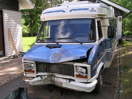

Hello all!
Long time without activity here, I've been too busy and something I have to leave.
On summer I made more activity for me...
I crashed our Hobby to the wooden electricity pole which was near road. Speed was about 60 km/h and there is only a one reason for crash, Me. I was driving alone and only damages to Hobby
I had time to choose, straight or turn a bit. I go straight and all problems are on front.
I'll continue story bit later...

Ooh Heaven!!
Jankos writing:
Not more? Its look like so mutch more kmh!!
Oh, I'm so sorry for You!
What will You doing now?
Scrap or repair?

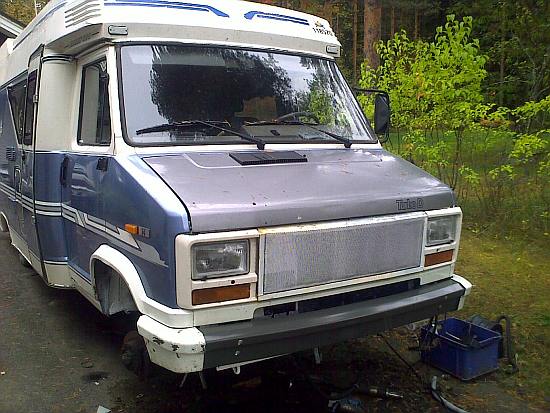

Actually it's technic is already OK, paintjob on some next months. And some parts are missing, right side mirror, etc.
Here isp iture where is all installed (no wheels) and it's running again.
Some list what needed for repair: power steering (engine destroy this one), all what is middle front, right drive saft, new bumper, oil pan, etc
Also I made some service by renewing clutch.

16 Nov. 2009 15:41
Ooh! :woohoo: It looks beautyfull!!
:daumen2:

16 Nov. 2009 15:48
Hallo Janni,
it is fine, that you are okay. It looks very bad on the first picture. But on the second picture, the Hobby looks again like a Ducato - congratulation. I hope, you find the last spareparts for the repair.
