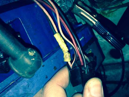

Ok, I think we're getting there! There was a black wire following the battery lead you pointed out. This black wire led to 'D Lichtmasch' on the control box under the seat. I don't know what 'D Lichtmasch' means as translators don't seem to understand it. But.. I disconnected this wire and hey presto, ignition on and the batteries are NOT connecting!!! YAY!!! :daumen2:
This black wire was connected to the glow relay, so would connect the batteries when the ignition was on. Now, do I now connect the black wire to the alternator output; I assume it would only connect the batteries when the engine is then running?

Hallo Daniel,
das eine Ende der schwarzen Leitung hast Du gefunden :daumen2: . Wo endet denn die schwarze Leitung im Motorraum? Mach am besten mal ein Foto.
D+ ist eine Klemme an der Lichtmaschine, die erst dann Spannung (+12V) bekommt, wenn die Lichtmaschine = der Motor sich dreht. Bei Peugeot haben aber nicht alle Lichtmaschinen diese Klemme. Deshalb bitte ein Foto!

In the engine compartment, it is attached to the glow relay. You can see it spliced into the pink wire.
It looks like the alternator terminal only has one connector which has a red and black wire attached to it; I assume this is to give power to the alternator when the ignition is switched on.
Where would you suggest connecting the black wire?

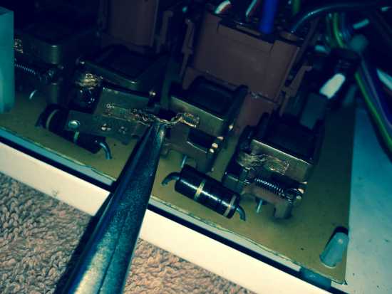

Sorry, more questions.... I'm in the process of fitting the Cyrix relay - it arrived this morning!
On your instructions 2e the message has become slightly lost in translation. I've removed the spring. Do I also need to cut the plate off where my pliars are pointing to?

Great, thank you. I didn't want to cut it off incase that wasn't what the instructions meant.
