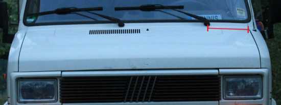

The welding (hopefully!) is all done so I'll be starting on the paintwork, or rather lots of prep for paintwork soon! The main job I think will be a nightmare is the wipers though for two main reasons, when I took them out the spindles were all rusted etc. so that's going to be a pain to make new bits so it can join to the scuttle panel and still work. Second problem is I fitted a new scuttle panel - the problem is they're not pre drilled. The old scuttle was very rusted, i can use it for the distance between the wipers but both sides of the scuttle were disintegrated. I need a measurement from the edge of the scuttle panel to one of the holes. Is someone able to measure the distance for me please? I'm happy it's getting there, the wife has booked some leave for the end of September so one way or another, it needs to be working ish for then.

kannst Du bitte ein Foto machen und dort einzeichnen, von wo bis wo Du gemessen haben möchtest.

Hallo Daniel und Wielfried,
ich habe es auch nicht ganz verstanden, welches Maß er braucht. Meine Vermutung ist das Windleitblech unterhalb der Frontscheibe mit den Scheibenwischer-Löchern ?
Ich habe gerade in diesem Beitrag geschaut, er hat das Lenkrad links, wie wir auch oder ?

Hello Daniel,
do you need the red marked distance in the following picture ?
You have a normal left hand drive like ours too right ?
If so, this could be a possibility for you.

I'm now about 200 euros worse of after buying this, wiper arms, wipers and a few other bits. At least I won't need to modify they existing rusted system - thankfully! I've just ordered it so hopefully it'll come this week. It should now be an easy fit which is needed as I need to have the motorhome ready by the end of September so we can go away in it. We're planning a trip around Scotland which should be fun. I just need the measurement as Marius drew above then I can get drilling. Must say I'm happy to see it all coming together!

Re: Wiper Measurement
20 Aug. 2014 12:22
Hi,
If possible, can someone tell me the measurement / distance as marked on the photo. I need to drill holes on the new scuttle panel and as a new wiper system has just arrived, I was hoping to get it done today?
Thanks,
Daniel
