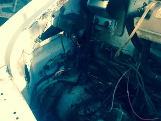

I decided not to weld the battery tray in place. I trial fitted it and it will bolt in place, I've just painted it and the air filter box etc. Once they dry I can fit them!
At least being bolt in I can keep an eye on it and make sure it won't rust under there... though with all the waxoil it's unlikely!
One question, where does the fuel filter fit to? I've been putting little bits and pieces back together today and and struggling to see where. Unless it's to the battery tray?

Hi Daniel, you ask, One question, where does the fuel filter fit to? I've been putting little bits and pieces back together today and and struggling to see where. Unless it's to the battery tray?
The fuel filter is located at the front part, across the fuel pump. Unfortunately i can't make photo's at this moment because i am painting our camper now.

Ah, excellent thanks. I was putting it all around and couldn't see where it fits. I maybe missing a bracket on the new front panel for it to fit but that is easily sorted.
All the engine wiring is (hopefully) all plugged in now with the exception of the lights and indicators. That'll be done once I make some brackets to mount the headlights. Another one of those 280 going to a 290 problems!
