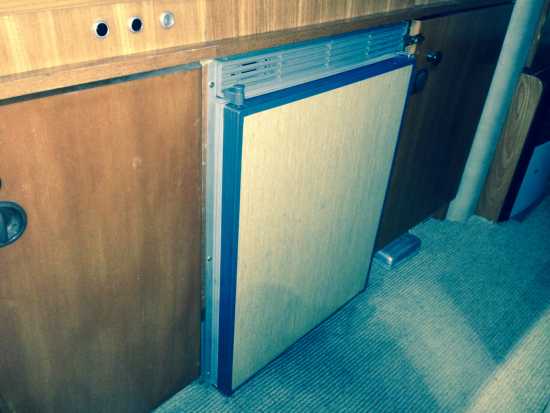

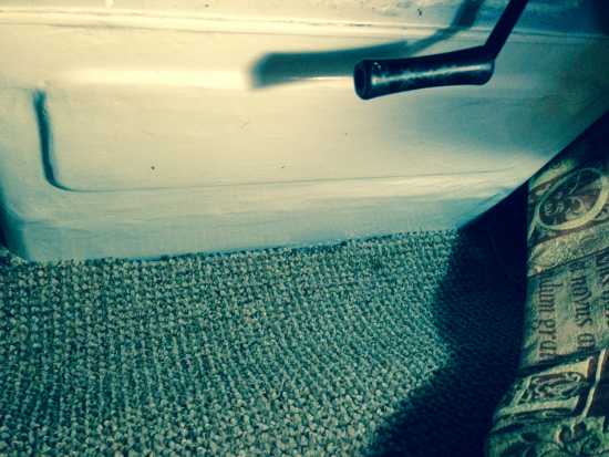

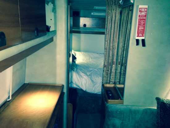

I had an older type heater and I bought a newer type case so modernise it a bit. A tv for the bedroom and lounge, both have satellite links for when I fit the satellite dish but they work brilliantly with the existing aerial. I turned the seat boxes around as they're much more usable that way. I also fitted a swivel device to the drivers seat. I cut the box down welded it back up and welded the handbrake in a lower position on the other side of the box due to moving it around. One picture shows a PS2 fitted for rainy days - they only run on 8.5v if memory serves correct. There's a picture of the electric fridge; the solar panels keeps it running 24/7.

I love looking at pictures of what people have done, thought I would post a few more myself. Not great pictures as it's dark but gives you an idea!
I cut down the drivers seat box as seen before. I didn't post a picture from the other side. I cut the section out that slopes in and made it straight. The reasoning for this, although the current batteries fit, i measured some other batteries which were a bit too bit to fit in. My making the box a touch bigger it means these bigger batteries will fit... just as well as I have just ordered them!

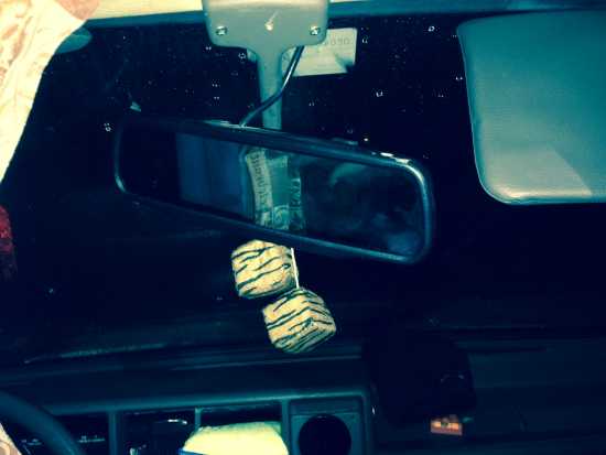

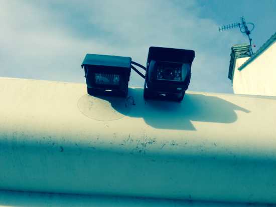

I've fitted a rear view camera as well. One points down for parking, the other points to the rear for normal driving. The monitors are in a rear view mirror. Pictures with it switched on and off.
Letzte Änderung: 12 Jan. 2015 20:09 von dsj1979.

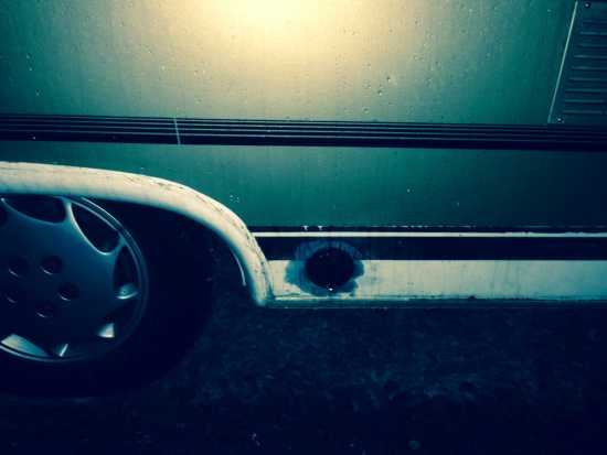

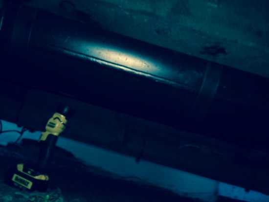

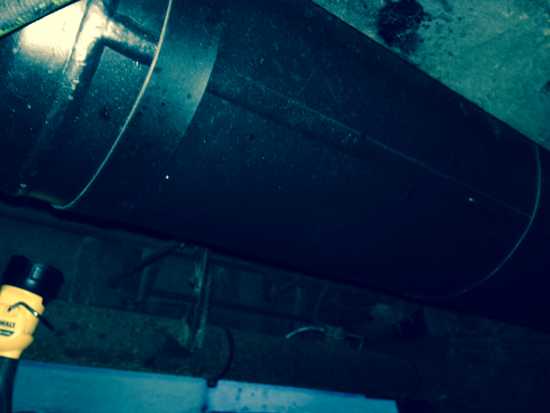

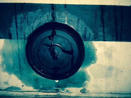

I also fitted an LPG system. This was so my wife can have the heating on without me moaning about using the gas. It's a lot cheaper to run and, it saves two bottles worth of space. By saving the space in the kitchen I will have room to fit an oven!
For the filler, I cut the hole but then used fibreglass to ensure the hole was waterproof. That was no water should run into the insulation. That's the blue tinge you can see on the outside.
Letzte Änderung: 12 Jan. 2015 20:16 von dsj1979.
